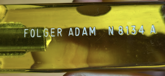

Ive seen a lot of security configurations for fasteners, but this is a new one for me.
I picked up this driver because i recognized the distinct vintage translucent yellow Snap-on handle and, what at first appeared to be a flat driver, was actually a bizarre wide profile tip with two pointed prongs.
.jpg
Some research revealed that Folger Adam (now Southern Folger) provided security equipment for jails/prisons and my hypothesis is that Snap-on manufactured and private branded these specialty drivers for their fasteners.
I found a picture online of a set of 5 different sized drivers, but not sure how many sizes were actually made.
These seem to be very rare and elusive.
Known screwdriver part numbers for the “set”:
N8130

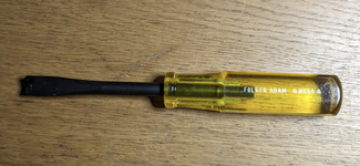

Picked this up in a lot today, appears to be new. Can't see the photos above of the fasteners mentioned, and can't find much of anything online about this tool other than probably the same photos of the set from Worthpoint.
Any info is much appreciated.

Decided to contact the company directly ( now Southern Folger) and a very nice sales guy responded with:
"That tool is for notched spanner screws. It is an older style security screw. Not a very common screw to find these days. Hope this helps."
So there you go. Here are the screws mentioned:

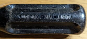

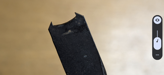

This one was in the same lot as the Folger Adam - Canadian security tool with adjustable width.
CanadianSecurityDriver-1.jpgCanadianSecurityDriver-4.jpgCanadianSecurityDriver-3.jpgCanadianSecurityDriver-2.jpg
