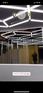

Hey, I’ve been going through a lot of the lighting threads and trying to make sense of it all. I’m overwhelmed with options and hoping some one might be willing to help.
I do high end auto detailing for a living and I’m about to move into a new shop. I’m trying to make the place very nice and have a lot of wow factor. I’ve decided to use a bunch of 8’ or 4’ strip lights in a pattern. I’ve laid out the pattern on a scale drawing and it comes out to 34- 8ft lights. It’s going to be over kill so I’m wanting to find a dimmable fixture. Cost is also a concern since there are so many.
The shop is
36’x 88’
15ft drywall ceiling that is probably getting painted black
Preferably 5000k fixture/bulbs
Higher CRI is ideal also
Could you help me in the right direction in what to look for?
The picture is the drawing. Each line represents an 8ft fixture
The second pic is another shop that was kind of the inspiration for the idea
Hmmm... there's something I never thought about... :headscrat
most people are concerned about more light. Does your name imply you do detailing and does a dark ceiling help in some way?
I don’t know a whole lot about lighting.. but I assume with the number of lights, the black ceiling won’t be an issue. I also hope it will make the pattern of the lights stand out more.
Yes, I do detailing. When doing paint correction (buffing/polishing) it’s best to to it in a dark place with black walls so the reflections don’t interfere with what you’re focused on. Also, scratches are typically white and can get lost in the reflection of a white wall/ceiling. You just use led spotlights with a very high cri rating (from a company called Scangrip).
The majority of the area of the shop will be car storage. I’ll have a work area for the major work and a wash area that will be well lit. Most of the jobs I do are more like restoration than cleaning and can typically take about 30-60 hours to complete.

If you don't find what you are looking for, you could set them up on multiple switches. Maybe 1/4 of the lights on each of 4 switches. It will take a lot more wire, but then you could have some of the same effect.
