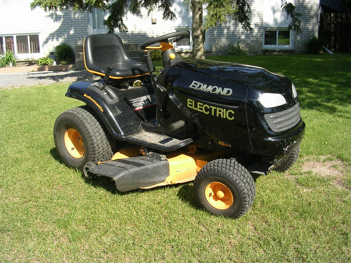

Something like this.
Do you have the video link referenced in the screenshot here, by chance? Would love to take a look at that just for curiosity's sake.
I do agree with @Stuart in MN that finding an old GE would be a great starting point, if one could be acquired. It would be a cool restomod kind of situation to just give one of those a heart transplant.
I don't have the property or the need to justify a riding mower (despite owning two located at my parent's property) but I have not been super happy with the availability of front wheel drive battery electric mowers on the market. I currently run a 2009 Toro Recycler with front wheel drive that I can't seem to kill, but I have toyed with the idea of electrifying it when the engine eventually dies.
