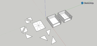

So I have this garage built in 1962 that was pretty obviously put up by someone's cousin Tony who "knew a thing or two about buildin' stuff". The slab is 6 inches thick in the middle, 3 inches thick on the perimeter. It has a massive grand canyon sized crack running east to west, and a smaller crack running north to south in an almost perfect cross. The whole building is leaning to the north, and it's pretty ugly as well (pictures attached).
Now the correct answer to the question I'm about to ask is "knock it down and start over", but I'm not looking for the correct answer. I have a finite amount of money and time to make this thing a slightly less terrible version of itself, and I'm weighing options to do exactly that.
First project is leveling the slab. I have come up with a few different ways to tackle this and I'm curious what you all might do in my situation. To raise the slab I plan on coring four 8" holes per section (sixteen total) and dropping a bottle jack into each hole. I'll then anchor sections of chain into the slab and cross it over the top of the jack so I can slowly jack the slab section level. I also plan on coring one 8" hole in the center to accomplish phase 2. Once the section is level I have thought of a few options:
1. Hire a concrete company to bring out a truck with rip fill slurry that is basically portland cement and water that will flow under the slab and then harden. I calculated it needing roughly 1.5 yards of material to do the entire building which was quoted at just over $500. If I wanted to do that I would need 16 bottle jacks and a ton of chain to pull it off. I can do it in four pours for an additional $300 which brings the grand total to roughly $800
2. Mix a portland slurry myself and do the pours section by section. This will take roughly 45 bags of portland at $18 a bag equaling around $800 dollars, plus the rental or purchase of a mixer.
3. Abandon the slurry and instead drill 1/4" holes in a grid across the slab and fill the void below the slab with spray foam. No idea if the foam would support the weight of the garage after the fact or if I would be able to fill the void either.
What option would you choose? What other ideas might you have? Has anyone else attempted something like this?

I actually already have the laser level, I did a pretty complete analysis of the slab when we bought the house and then laid it out in sketchup to figure out exactly how far the slab had dropped in each area. That's also how I calculated how much fill it would take to bring it back to level and also design the lighting
I'm going to keep working on the model to get an accurate idea of how far it's racking and if the corners are in square as well. Lifting the building also gives me the opportunity to address the sill plates that have rotted away from the amount of water intrusion.
Storage unit is a decent option, and you're right about it being a motivating tool. I just tend to have super heavy stuff so I hate the idea of moving it at all. Garage.pngGarage (1).png
