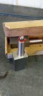

Wanted to come back here with an update. Over the winter I fumbled for quite a while with a pair of wiper motors, if I went that route I would have had to fab up a frame and figure out external limit switches and weather proofing.
On Saturday I stumbled upon a legit satellite dish actuator, VonWeise branded model V76-5. All I can seem to find is a simple sales related spec chart, this model was 36vdc, 11" per minute travel, has reed switch positioning, 24" of stoke and a starting load of 800#.
Sadly I didn't get any pics before tearing it down but suffice to say the motor is shot, the lead nut was seized and the inner screw tube locked against the outer tube.
So everything that should move but couldn't now does. Lead screw and nut (plastic) are both cleaned up and physically everything except the motor is re-usable. Turns out at some point the rear cover on the motor housing was bashed and broke in half.. the weather did the rest as I found it ***-up in the pile.
Even if I could source another rear cover plate that would work, there's one winding wire that's broken off the commutator. Even without that I bet the armature itself is shot.
Having misplaced my calipers.. again dammit, I haven't measured but looks to be the same diameter housing as a typical riding mower starter. I'm definitely going to spend the time to try getting a compatible armature and housing because the builtin limit switches, and that reed switch being integrated into the main gear housing will be a huge boon to the overall project.

You said the motor is shot. In what way? The photo of the armature shows some non critical corrosion. The commutator looks serviceable. The winding do not appear to be burned or broken and should be usable.
Walta
S
skeer
Sep 14, 2021
1,049
Standish, MI Area
Yeah it's super hard to see in a pic but a single wire is broken from the commutator 'terminal'(?). I have no idea if that can be reattached somehow. Also it's weird.. I put this into the electrolysis bath over night to help clean it up because it was FILTHY. A day later the white stuff started forming on the plate edges.
But if I can reattach that wire then I might be able to salvage this.. provided the rear plate I have that's intact fits properly.

So I **** as soldering tiny things. The spot where these two need to meet is so tiny I can't really scrub or scrape it. An alcoholed q-tip didnt do enough and even with flux it didnt want to stick.

Alrighty so.. second actuator fully disassembled and cleaned. The lead nut is intact in this one and since I don;t want to risk damaging it by removing I'll leave it in and just use that section of the arm.
The motor case and rear cap are in good shape.. armature is dare I say a bit newer. That or perhaps the first one I picked up got too hot. In any case there's nothing broken or really corroded on it save one of the teeth on the gear end. Both bearings were obviously shot so they've been cut off and I have new ones ordered. (General bearing R6-07)
I did attempt to remove the bearing off the first armature but ended up just pushing the commutator down a bit. I should REALLY buy a bearing puller...
All end is identical so far, still plastic gears however the main one that directly interfaces with the lead screw is black... possibly a different material?

While Im waiting on the bearings to arrive, I attacked the brush assembly. These motors are weird to me in that the commutator is at the 'front' end instead of the rear. In any case the first motors brushes were wedge in the little holders, springs long gone from corrosion. the braided wires were in worse condition than the second motor was.
So I drilled out the rivets holding that assembly in and swapped it with the one from the second motor. Repurposed an ink pen spring, cleaned up the sides of each brush and they move freely and I think with enough holding force from the pen spring.
