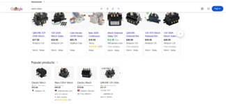

I have a cheap winch on my truck bed. The motor is 40 amps. I have a 40 amp circuit breaker. The relays in the winch control box are 40 amp. They keep burning the point and sticking. The also have excessive up and down movement. The relays are Liming LR4190-DC12V-1C 40 amp/14DC. The cost about $7 each. My question is, to stop the burning do I need a higher amp relay or a better quality? How to you determine if a relay is a better quality?

I think if you do a search for “12V winch relay” you will find they are generally rated for over 250 Amps and Amazon will deliver it for about $23
