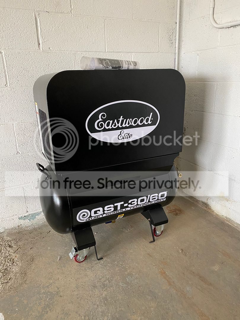

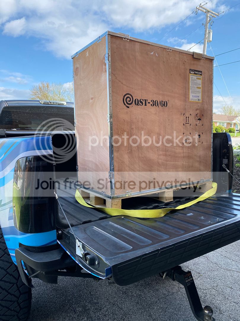

Sorry I have been a little absent. I have been working on other home renovations to get the house move in ready. A little update addition for the garage though! Went to finally pick this thing up and it fits perfect in the back corner of the garage. Cant wait to get it hooked up and running!
