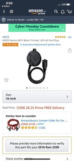

Had this on my last truck. Ends would still be live but at least hidden. Why not run cord up to front and just plug/unplug there as needed94605b16b6d097c3dd171dd1f4519322.jpg
