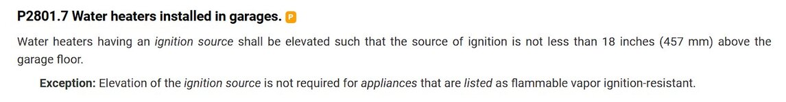

Isn't it a code requirement for a gas WH to be elevated 18"?
Yes, in a garage or other area where flammables might be stored. Some gas heaters are rated for installation at floor level. Bradford White makes one called the Defender. I had a hell of time convincing the moronic home inspector and the plumber they called in on the sale of our last house. They just flatly refused to read the manual or the web site.

They're called "flammable vapor ignition-resistant" water heaters. Google it. As I read codes there is an exception to them bring elevated 18" in garages. I thought that all gas water heaters produced in last 10-15 years were FVIR. Introduced in 2003. I find sources saying all were FVIR in 2015. Thought it was around 2006 but not finding that citation now.

The IRC has an exception for appliances that are listed as flammable vapor ignition-resistant. Local codes could be different I expect.

Don't know what jurisdiction you are in but it seems most of Texas uses either the 2018 or 2021 edition of IRC and both have the FVIR exception. No telling what a local jurisdiction may do.

I'd say it's for water heaters. Here's the code:
P2801.6 Water heaters installed in garages.
Water heaters having an ignition source shall be elevated such that the source of ignition is not less than 18 inches (457 mm) above the garage floor.
Exception: Elevation of the ignition source is not required for appliances that are listed as flammable vapor ignition-resistant.
And here's the code definition of water heater:
[MP]WATER HEATER. Any heating appliance or equipment that heats potable water and supplies such water to the potable hot water distribution system. For the definition applicable in Chapter 24, see Section G2403.
