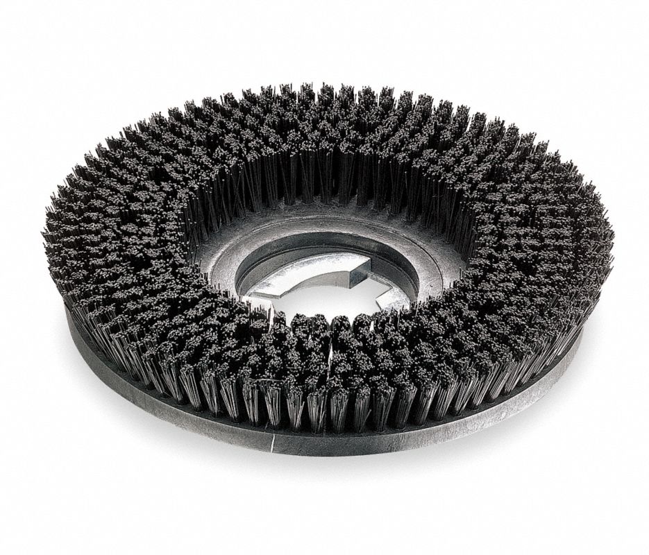

So, I poured some hydrogen peroxide down on 5x5ft area and scrubbed with floor scrubbing brush and got some of the dust up.
I ordered a rotary scrubbing brush that I can attach to the home depot floor polisher rental and 4 gallons of hydrogen peroxide to speed up the process. I'll be doing the scrubbing this sat so, I'll post some photos when I'm done.
https://static.grainger.com/rp/s/is/image/Grainger/3U955_AS01?hei=800&wid=935
It may be pride at this point but, I really wanted to do the work myself for the sense of accomplishment. If the scrubbing doesn't work I will probably have to hire someone get the dust up.
Thanks!
F
Dec 24, 2018
19
Renton, WA
Got all the dust up! The rotary scrubbing brush worked awesome. I ended up going over it a couple times but, it's super clean now. There are a few spots I'd like to scrub by hand but, at this point I'm trying to decide if I want to have the floor professionally ground. There are a few spots where the single head grinder did a really good job but, I would love to get the whole floor clean and down to the bare concrete.
