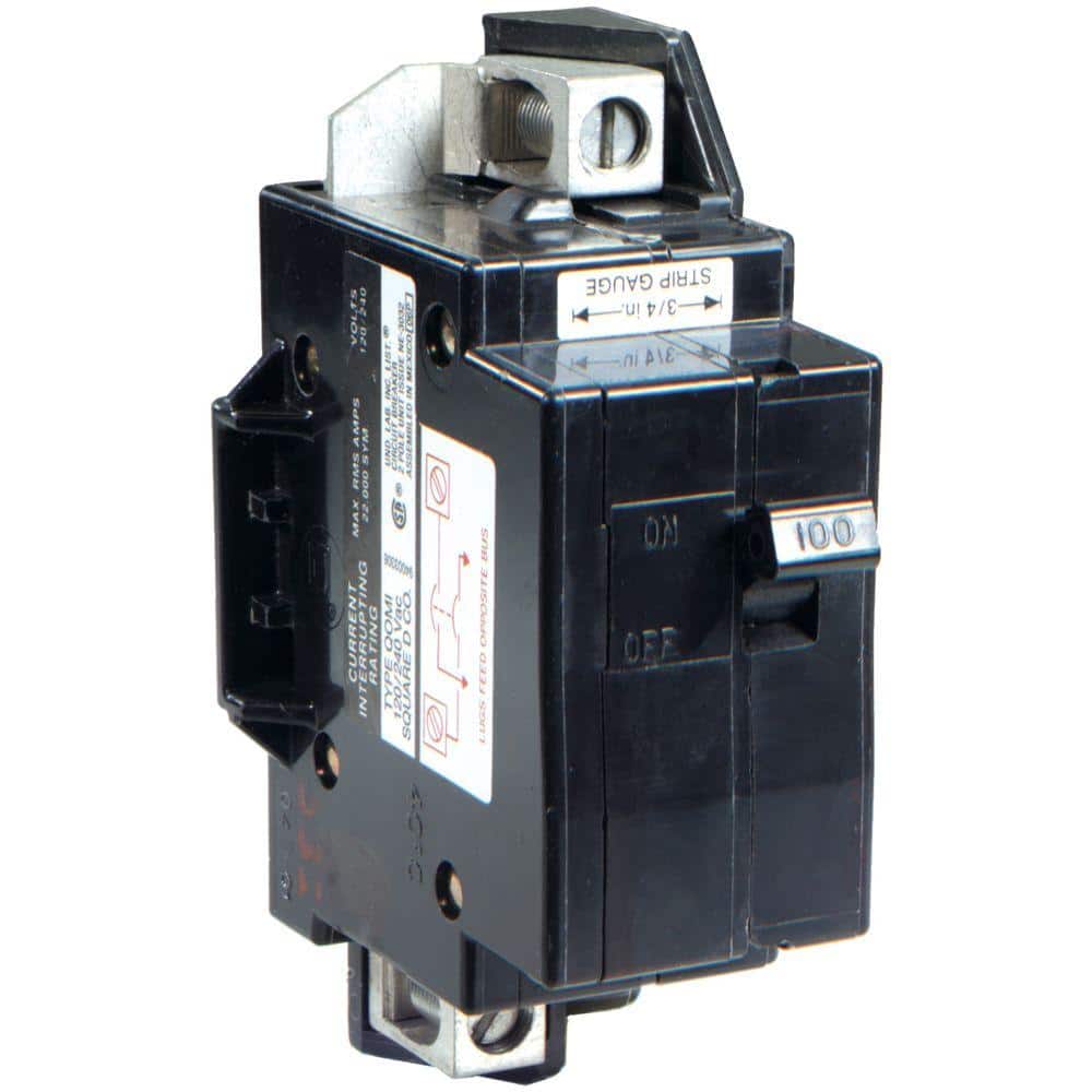

Some '200A' panels have a 225A breaker available. Are any PoCo's entertaining this size service?
For an UG feed the POCO wires will go up the right side gutter and loop over to the upper terminals.
Did you notice that panel has studs and not clamping lugs? You'll need some ring terminal ends or a dual lug kit.
I was going by your 212A calculation.bus bar rated to 225a is a thing i've seen. im still 20a short tho.
oh thats just a load calc.I was going by your 212A calculation.
I know I can get a 225A QO main breaker, and many of their panels have 225A rated bus.
