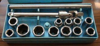

There were lots of European manufacturers of female drive tools. (A few Russian ones as well.)
  • Russian 15-pc 10mm (3.8) drive Metric socket set (Ebay 172471378976 02).jpg
