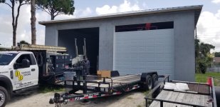

I have been caught up with other details about my garage build but I am almost ready for the the electrical. The overhead garage doors are in and I really had not considered how they will block some of my lighting if I have them up at night and I probably will, at least partially.
So, here is a copy of my layout and I approx drew in the doors in the fully up position. Wondering if I should rethink my layout or am I over thinking it?
The option I am thinking is to move the two highbay fixtures that would be behind the open doors to the sides where I show them in red and slightly angle them toward the center.

I have the same issue with 3 14' doors. You have the space on the sides. You have white walls so I'd think you would get good reflection if they were not angled.
I'll watch for others ideas.
