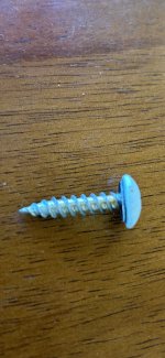

I've gone down a rat hole looking for the screws. I've learned a lot about screws but I still can't find these. The contractor's no help.
The screws they used are #12 sheet metal screws with an extra pointy tip for self drilling through thin sheet metal. The head is what I think is a truss head, with a #3 square drive. There's a thin gasket under the head. And the heads are painted white. These are 1" long.
I've been through a bunch of screw catalogs. So far the closest I've found is either #10 square drives or #12 phillips. I realize that as long as I get close no one but me will notice, but I'd like to find the exact ones if I can.

Try a mobile home supply to see if they can help.

Those are used on enclosed trailer interiors. These are "double square"
Enclosed Trailer Screws Self Tapping White 100 Pack #10 x 3/4 Inch | Self-Drilling Sheet Metal Screws with #2 SQ Drive Bit, Enclosed Cargo Trailer, Universal RV Fasteners, Zinc-Plated: Amazon.com: Industrial & Scientific https://share.google/XWeaTAD3ucLLVB7TT

Thanks all. I found some #10 square drive pan heads in white from Clips and Fasteners. I need to get this done and they're close to the right part.
