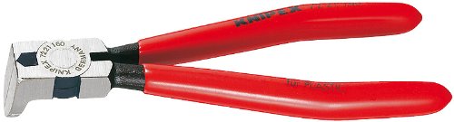

Flush cutters
T45
Nov 20, 2014
3,255
How many of ya'll use them regularly and what styles do you prefer?
Do you use them only for what they were intended (eg electronics) or do you also use them on plastic (eg zip ties) or do you have special pliers for each? I see knipex and snap on amongst others make 'plastik' cutters (eg knipex 72 01 160) and snap-on EPC160 (aka, Bahco 2101PG-160)

I have the knipex, thought they were silly at first, but they are the best for zip ties. End of discussion

I use a pair of Knipex flush cutters for all zip ties I install also. They will cut a zip tie perfectly without leaving the killer sharp tag end. I have laid myself open on them many times.

i dont think they are for electronics,they say for plastic on them.xurons for the micro style.still made in USA.
knipex for the bigger pair.
