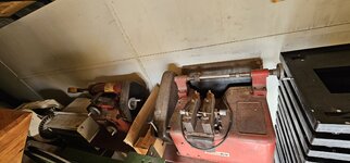

Was looking for some help in identifying these. I know Ford Rotunda is the brand. Thanks in advance
R rocky2024 New member Joined Sep 24, 2024 Messages 1 Sep 24, 2024 #1 Was looking for some help in identifying these. I know Ford Rotunda is the brand. Thanks in advance
L leadfoot415 Well-known member Joined Nov 28, 2012 Messages 1,292 Location Livonia, MI Sep 24, 2024 #2 I believe that is a rotunda/ford brake lathe built by Kwik-way, probably atleast 30-40 years old. I have only seen a few that look like that, many years ago when I first started in the trade.
T Technologyteacher Well-known member Joined Jan 10, 2017 Messages 4,660 Location Elkin NC Sep 25, 2024 #3 Looks like a unit I have made by Bear
G gorilla Well-known member Joined Dec 13, 2007 Messages 1,660 Sep 25, 2024 #4 That is a Kwik-Way profit pair. One is for drums one is for rotors. If you don't have the cones and adapters their not good for much.
