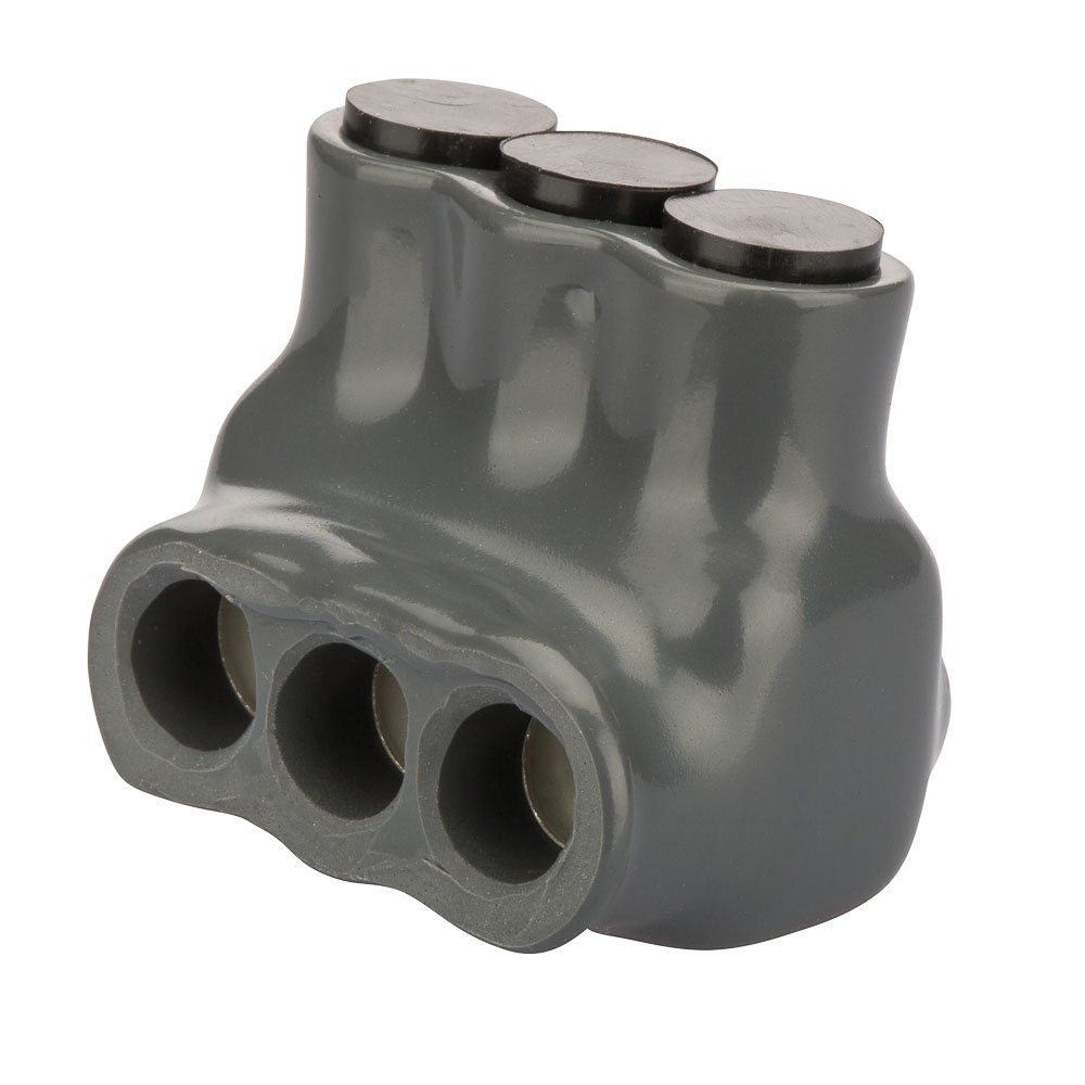

Can I tap the neutral and ground wire off the feeder wires with 3 way splice connectors in a separate junction box then bring it into panel 1?
Instead of having a neutral connected to the neutral bus of panel 1 then bringing it downstream again?
Do you see a problem doing the neutral that way? Let's say in theory I shut off the feed to work on panel 2 while panel 1 is all energized (except the feed breaker to panel 2 turned off) will panel 1's neutral current flow to panel 2 creating a dangerous condition?
I looked at it tapping rules and it can get complicated, doing its with a breaker (sub to sub) is not considered tapping right? And it seems like tapping rules only applies to ungrounded conductors, not with ground and neutral.
By the way I am redoing the feeder ground wires between the panels THHN AWG 10. It seems it is allowed below 60 Amps. The neutral and 2 hots are THHN AWG 6 to all the places, in conduit

Just from a connectivity standpoint you could use a 3-way polaris-type connector for the neutral, but its just extra cost. The neutral bar is right there anyway and presumably has plenty of free holes for "new work".
It would be wise in my opinion to label the "downstream feed" neutral so it doesn't get disconnected (remove screw) in the future inadvertently, if one were relocating some white-jacket conductors. As that would disable the downstream subpanel and could draw an arc depending on load. Usually there's a visual clue because of the large conductor size but always good to label. Memories get shorter every year ;)

Hello after further study NEC Tap rules
I realized if I tap the feeder awg 6 with awg 6 would not be a tap because a NEC Tap means smaller wire. So I am forgetting about feed though panels etc.
I now plan to splce the feeder including the ground and neutral with a 3 way Polaris connector instead of doing with a breaker from 1 to 2. The splice will happen in a big pvc box 12”x12”. With 3 conduit drilled. a new wire will be run from splice point to 2 so there is slack. The cut wire is reused to go the panel 1.
The main reason is there is some fill issues with conduit I plan to use going back and forth when wiring in series as was suggested.
As far as I know both ways are legal. Please let me know if otherwise.
I plan to replace the 50a with 60a at the upstream. I realize 55a is max working current but a 5A extra capacity could be useful. I do plan to make a label at each panel and what is the max rating of upstream OPCD.
I also plan to buy the new load center with 6 spaces so there isn’t ample free space to overload with breakers. I only use full size breakers at this point.
