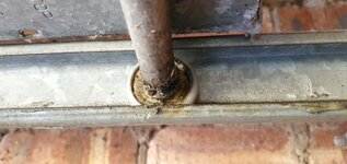

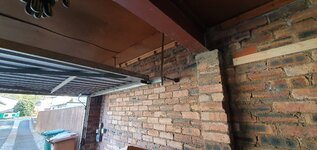

Hi all,
I'm thinking to do a bit of a service on our garage door. We've only lived in the house for a year but I think the door and opener are at least 25years old. I've attached pictures of a lot of the lubricated parts minus the opener and chain as according to the manual these don't need maintenance/lubrication-probably they do after 25years though! I guess I'm seeking advice as to whether I should remove all grease and start again? Some of it is contaminated, you can see the rollers are gunked up. And if removal and start afresh is a good idea how do you remove this kind of grease? I think just adding a different product on top would be a bad idea. Also springs seem greased too but wondering if that would have been done with a different product and if so what is a good replacement? Was thinking lithium grease for most parts as this is what seems to be recommended online.
Thanks for any advice.

I can't believe that door even works. Hit it with garage door lube and wipe all the gunk off with a rag. It will be quieter and work great for two days at which point it will catastrophically fail.

I'd clean it up and see how long she runs. The most important thing for smooth operation is cleaning and lubing the big torsion spring.

Grease is bad because the dust/dirt/debris get stuck in the grease and act as a abrasive rather then a lubricant.
Wipe off the best you can and use a garage door spray lube twice a year.

there's been lots of lube on that door over the years by the looks of it.
kind of an ugly mess.
Mineral spirits and an old brush would clean that up pretty quickly . just put something down on the floor to catch the drippings .
I have a can of Lube the door guy gave me, as well as another can I bought. not sure of the brands . a bit oil on the spring every once in a while is a good idea too .

All cleaned up, tracks were filthy with grease too and rollers were dragging and not turning. I decided to use a spray wd40 lithium grease on moving parts except the springs on which I used a wd40 silicone spray. Will see how these do for it. Seems to run fine but then it ran ok with all the gunk that was there previously! Thanks the advice

Keep in mind here that the people selling "garage door lube" don't mean this style garage door. I would not just assume the words printed on the can are the ultimate appeal to a higher power.
With that style bearing and the obvious heavy loads, you'd want a heavy grease on the kickout mechanism.
On the tracks, you'd want no lubricant ever. I think that is pretty obvious but you all discuss amongst yourselves. The track wheels don't require lubricant anywhere but they could certainly be a little quieter if they are. There's just no weight on them to speak of.
the springs don't require grease but it doesn't hurt them. Maybe somebody wanted to stop them from rusting.

The lubed tracks would help quiet down the ride of the rollers a small bit. The roller's axles need a lube to move freely, stay quiet and prolong wear. The springs certainly need a lube to ease friction of the coils between each other. I prefer a small dribble of oil across the length of the springs, as mentioned already by BILLK. Certainly it would slow down rust encroaching. After oiling, I run a few up/down cycles, then wipe any excess that would drip. Wiping a few times for a day or two.
Then of course all the hinges, drums, cable connection points, cables as well for rust prevent, all bearings of the long horizontal shaft. Of course chains, screw drives, And the bracket that connects the door to the trolley arm.
Any point that metal rubs on metal should be lubed with simple WD-40, or lithium grease for chains & screw drives, twice a year. Metal to plastic or nylon parts can benefit while one is spraying everything else.

All the grease you see isn't doing anything. Clean it off if you want to but I'd avoid washing grease out of the pivot points.
Garage door lube is usually lithium or silicone spray. I haven't done extensive testing but seems like the lithium is a bit thicker and messier (white build up, collects dirt) but lasts longer.
