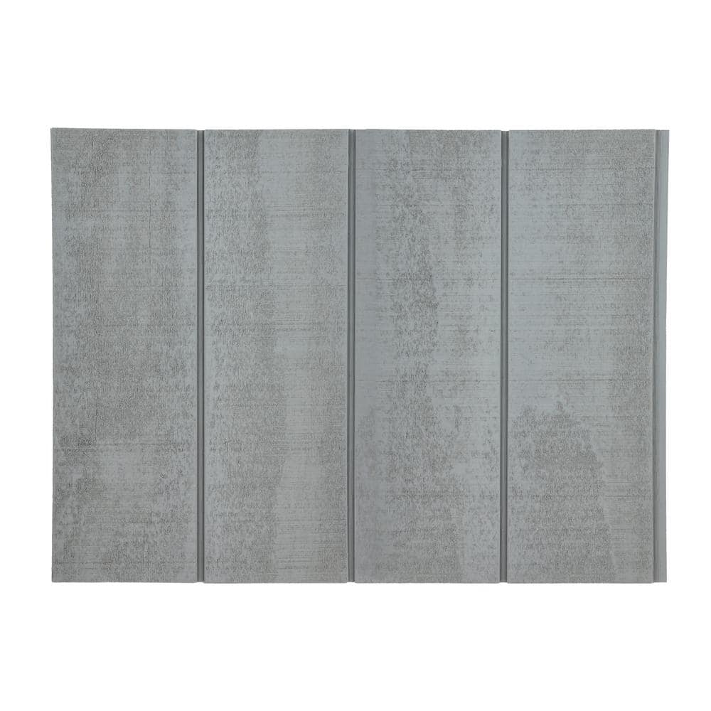

Ok I have built a ton of this type of door. Now there are some things that you would not be able to replicate because of production items I had available to me, but I will say that the linked page is a very good resource. Some notes I will add though:
On your door size, your opening is larger because it had a one piece door. You can very easily get an 8'2" wide sectional door, and that is what I would do. Commercial doors commonly come in +2" lengths. Your one piece door was meant to fit and operate within the opening, that's why it is larger. The sectional door is meant to be behind the opening. If you try and run the wood off the end of the door to make it wider, you are going to cause all kinds of issues with the track and hinges and such.
Next thing, lay out all of your boards before you start and number them. The boards will not all fit together well and it takes mixing and matching. Make sure you don't have any knots where you will be cutting.
To make tight gaps, figure out what saw you are going to use. Measure out what the kerf is. Make shims to match the width of the kerf and put them between the sections before you strap them together.
I didn't use saw horses, I worked on cardboard laid out on the ground. Two people is a must pretty much, and three is helpful to glue while the other two place boards.
Mark the back of the boards so you don't glue across the section joints. It's a pain to clean up.
Find a good straight edge to use as a saw guide. If the door is getting trim over the tongue and groove, screw down to the door under where the trim will be. If it is just tongue and groove, you have to get creative to clamp it down. Almost all of them that I built were trimmed, so I screwed my guide in at multiple locations including the middle to assure a straight cut. I used a cordless circular saw set to just cut through the t&g with a thin kerf blade.
As far as adhesive goes, liquid nails will hold, but it is a PAIN to deal with because it takes so long to set up. Getting things to stay in place while it cures is touch. I used hot melt urethane adhesive from a drum. I would apply it to a board, put the board in place, and place a weight over the board and move to the next board. By the time I had the next board down, the previous one wasn't going anywhere. The adhesive only had an open time of like 90 seconds at the bead size I was applying. There may be some products like Gorilla Glue that would perform similarly but I don't know that I have a good recommendation there.
Also I don't recommend trying to do any sort of angle cut if you are using cedar or something similar. Your sharp corners will not hold up and it will look like ****.
Also, wherever you get the door from (don't try and deal with a box store) will need to know the weight of the door after its built to spring it. They will also need to know that the door is going to be additional thickness. Good door guys will know what all needs to change, but it is multiple items. At the size you are talking about, you shouldn't need to get crazy with track and hardware if you start with a decent door.

Thanks for both of your responses. I attached a photo of my current garage. One thing for me to clear up, is I wouldn’t be extending the wood I apply to the metal door beyond its edges.
Next, the wood I would be using is plywood siding to match my current garage door (need it to match best I can for the HOA).
Here’s what id get:
They come in 4’x8’. Id guess is have to get 3 to cover the extra 2 inches.
I didn’t know I could get a door at 8’2” easily. The picture I put black arrows was my thought to just add some type of thin wood frame around the garage opening, like 1”x1”x7’, and I would just add one in the top to match. But doesn’t look like ill need this if I get the 8’2”x7’ door.
Also, this complex was built in the 80’s. What are those attachments on the door next to the blue arrows? Ive never seen these before.
I’ll have to add those and the vents/frame as well so it matches my current door appearance.
