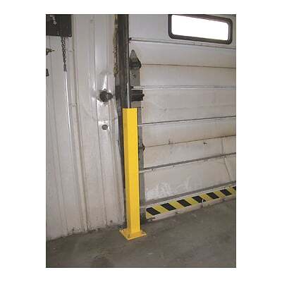

I keep bumping the safety sensors out of alignment either with my foot, Air hose or stuff in the corner of the garage. Has anyone created a sensor protector/shield to help keep them from getting bumped out of alignment? I could mount them above the garage door but that disables the need for them. I would like to keep them installed.

Cardboard Man
Aug 30, 2008
810
We use these in the warehouse to help protect from forklift damage. Could work for your application as well, or you could make them with scrap you have laying around.

Bend up a piece of flat bar into a 'C', with bent tabs at each end that you can mount to the wall vertically over each sensor. Use whatever stock width you have, 2" or so should be enough to protect it but you can go as wide as you need to. Drill some holes through the face if you want to access the sensor screws for adjustment, or just pop off the guards if you ever need to adjust.
I've had this on my to-do list for a while (years) but have not gotten to it yet lol....
