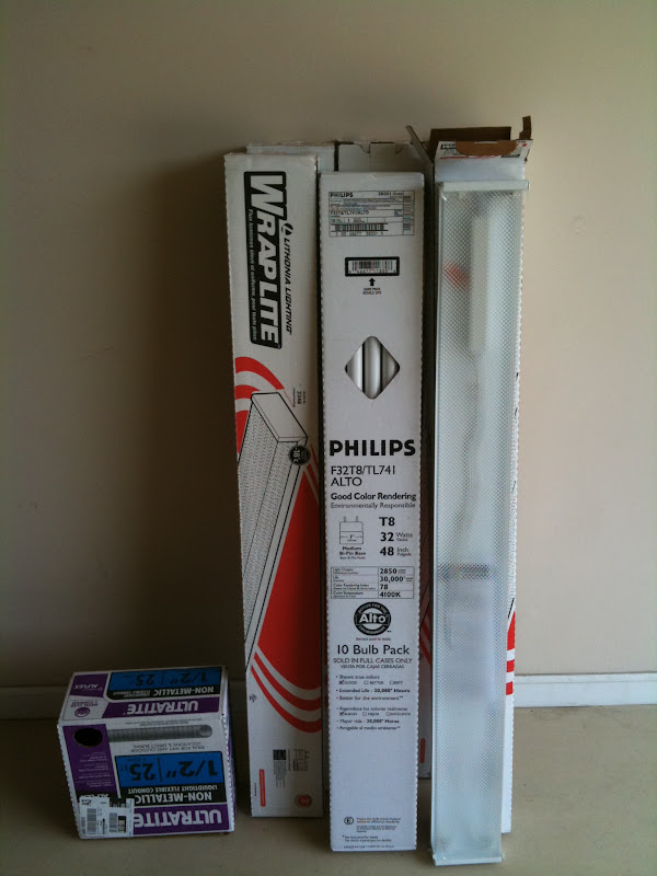

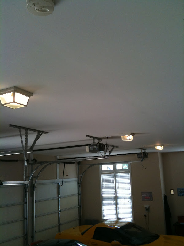

OK, after too many years of not having enough light I figured it was time to make an upgrade.
This is what I'm starting with!:wtf: Remind me to thank the builder!
I've decide to go with 5 2x48 T8 fixtures. 3 will go in the same location as the original "outdoor lights", then with some flex conduit I'll run two on either side of the center bay over the walk way in between the cars. Those two will be parallel to the walking/working area and perpendicular to the other lights. I used a format like this in my wood working shop to help reduce shadows and it worked pretty well.
This is what I'm working with, the fixtures are only about $19, so with bulbs and related parts I'll only have maybe $125 in this job.
I figure I can do this and then assess how bright it is and add a couple more toward the doors of the garage as needed. We'll see soon enough!

Spend some extra money now & buy a better quality fixture, the ballasts are cheap in that model & for the money the Lithonia "LB" series wraparound is a much better choice, with the cost of a replacement ballast being almost the cost of that one you bought when they fail & one is still left w/ cheap $19 fixture costing about the same as a better model.
The next model I could see up the line at HD was a $29 version, I think another Lithonia, but the plastic cover was a milky white plastic. The looks good in a kitchen but I felt that it would not let as much light through as this more "crystal" like clear plastic finish.

One of the reasons I like/recommend the Lithonia LB series fixture is the diffuser is easy to find a replacement for, plus the ballast is fairly decent also, the 19 buck model will not be as easy to replace IMO, and for the price the ballast is cheap as they can get, I think HD charges $38-39.00 for LB wrap.

You can see from the first picture of the ceiling that I have 3 junction boxes, one at the front of each bay and that is it. So putting up 3 lights is a no brainer. In order to add more light to get better directional coverage I want to add a couple in he space between where the cars are park to light the sides of vehicles.
Last night I began to add a box in the first space, cut the hole and began to try to get a fish tape through, then put my arm up in the whole to find that this area of the house is built with the solid type engineered lumber I-beam, not the type that is open with angled cross pieces. So I patched the whole and figured I'd go back to the original plan of running the extra lights on the ceiling.
Your point on code may be more involved, I was planning to just put the conduit into the end of the fixture and secure it and run the romex from unit to unit and wire it with no junction boxes. If I do this with rigid or flex, I'm not sure if that meets code? I know some places like bathroom vanity lights, I've seen where the romex just comes out of the wall into a fixture? I'm not a practicing or licensed electrician but I have sen that on some newer construction homes, doesn't mean it is right!
So how would you guy suggest adding lighting locations without tearing down the ceiling and starting over with wiring! :wtf: I would like it to be code compliant if possible.

Yeah that is what I found up in there. The space above is a bedroom so no luck there. The joists run the direction of the cars, I need to get sideways from those boxes.
I agree that I would prefer to put in boxes and hide all the electrical, but short of putting an access hole every 16-24" to get into the space and drill holes I don't know how to pull that off. :headscrat
One possibility that might be happening is in that hole I went toward the j-box on my left and found the I-beam I couldn't get through. Maybe they put one of that type in that location to cary more load from up above and maybe the opposite direction to my right they had the other "open" I-beam type product? I just don't feel like tearing up the ceiling to just look around!

So after thinking it through I decide to go ahead and cut through he dry wall and place a few J-boxes between the bay to add the light where I'd like them, and to hide all the wiring and keep the ceiling clean.
So I cut a 4" x 40" trough in the drywall. I figured I'd have to drill a few 1/2" holes through the I-beams and then button the ceiling back up and mud. I find a main supporting beam made up of 1 I-beam and 3 1 1/2" Lam beams!!!!! Also it is some tight to the other beams that I can't get a normal drill in there and I don't have a right angle drill or extra long auger or drill bits!!!!

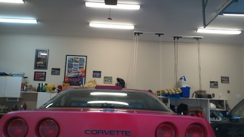

OK, got things done over the weekend and I'm pleased with the results. While I agree that the fixtures I chose are not top quality at $19 a pop I think I'll be fine as these lights aren't used a ton. If I have a ballast go out it will be just as easy to replace the unit at that cost.

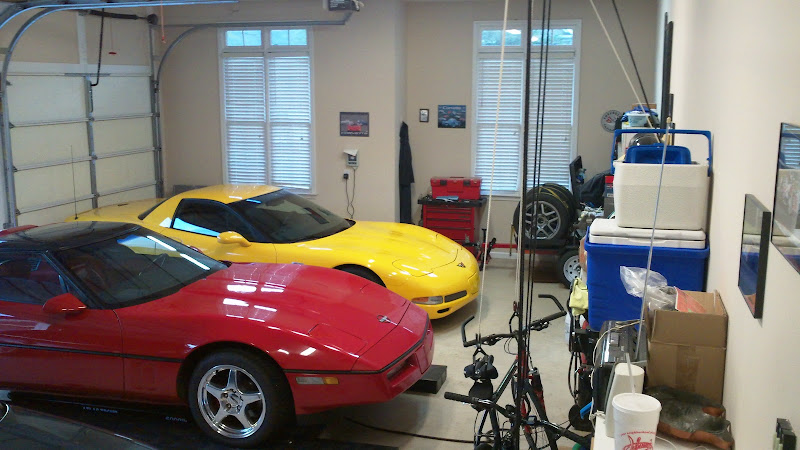

Here is a picture of the garage with only lighting from outside about 7:30 pm
101_0009.JPG"

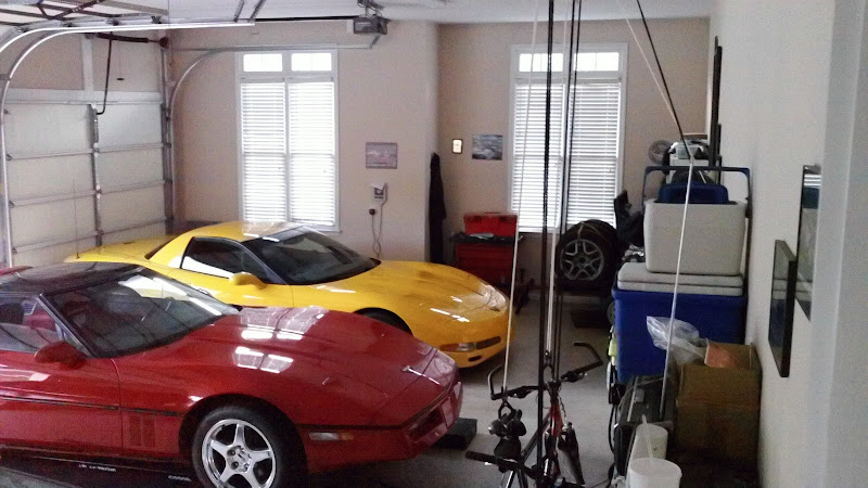

And here it is with the lights on.
I wanted to use multiple fixture from multiple positions to eliminate shadows so I added 3 boxes in line with the existing one's the builder put in and put up 6 2 bulb fixtures
I'm pleased with how the light fill the space
If I feel I need a little more on the back side of the garage I can add one more of these above each bay in line with the two others!
Glad this is done
