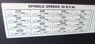

Get one that goes down to 250 RPM or so, it will be the last one you'll buy. I found an old HF #38142 DP that needed a motor, for $40. You need three pulleys.
