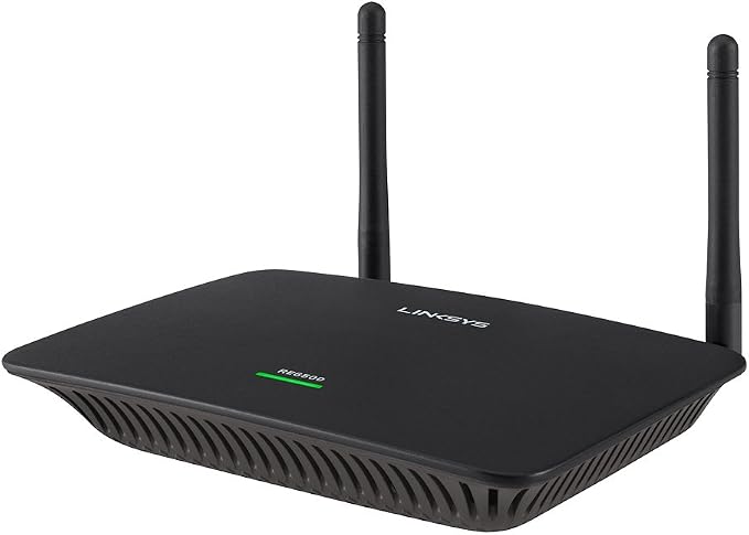

How far away from your house is the barn? You could use a WiFi repeater or extender to make it reach further. For best network you would want to run Network Cable to your router and then all the way out to your barn. Or put another router/switch in your garage, but either way for the BEST network you have to connect to your main router.

From the house to the nearest corner of the barn will be maybe 75'. Can I get a repeater to go that far?
sure. it can go miles upon miles.
i'm partial to the ubiquiti line of products. you willing to toss everything out and get one clean solution for ALL things wifi, internet and beaming it to the shop?
