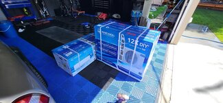

I recently installed their 115V system in my garage - still have to wire it up into a disconnect and to the panel but otherwise, it's an absolute plus when you don't have to pay an HVAC guy to work the lines. Granted, by DIY it essentially voids the warranty, as Mr. Cool requires a certified tech to honor the warranty.
53184254737_416b098e5e_b.jpg20230714_120946 by Sergio Zapien, on Flickr
53185335193_e02701ee26_b.jpg20230905_170956 by Sergio Zapien, on Flickr
53185335203_9a8f434151_b.jpg20230905_171026 by Sergio Zapien, on Flickr

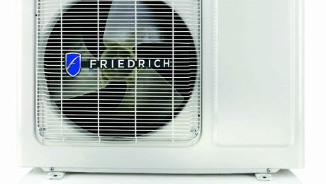

Before they became Mr. Cool, they were Friedrich and I have one of those systems for my house and it's been great for the last 10 years. So in short, it's been great for me thus far.
Are you sure that they are the same company?
Fridrich is a domestic HVAC company headquartered here in my state. I knew a few people that worked there. When they jumped on the mini-split bandwagon, they were simply importing from China and branding the units. If they actually own "Mr. Cool" - that probably saved their business.
I think you're right to question my initial statement - it seems the Friedrich simply pulled out of the "DIY" products around the time I bought my 1st unit and the supplier at the time simply stated they were replaced with Texas based Mr. Cool products later on down the road.
Doesn't seem to have any affiliation with one another after all.

I began representing Fujitsu in ‘97 for the six New England States. At that time they sold units to Friedrich which they marketed under their own brand. That drove me nuts because they promoted it as “Fujitsu” made. We were in the early market building years as Fujitsu had only been in the States since ‘94 and it was before the 410a inverters. Fujitsu tried to calm us down by telling us they always sold Friedrich the previous generation products. As I recall they terminated that relationship at about the time the inverters came out, and Friedrich went elsewhere for minis. They are a big brand name but not a manuf of mini-splits.
