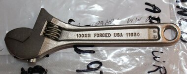

There is no question that Granco was outsourcing at least part of their product line:
Granco 11650 4-in adjustable wrench(photos ebay)
The odd wrenches, however, seem to have been made in house:
Granco 16130 9/16" flare nut/box end wrench (photo ebay)
Pure conjecture and speculation on my part, but it sure looks to me like Granco was stamping out some very specialized wrenches and torque adapters for the military, but outsourcing sockets (perhaps from National Hand Tools out of Dallas?) and (obviously) their adjustable wrenches from Western Forge. Just my lousy opinion, of course.
