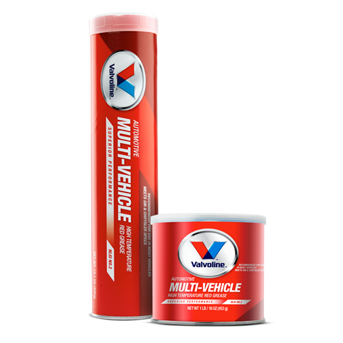

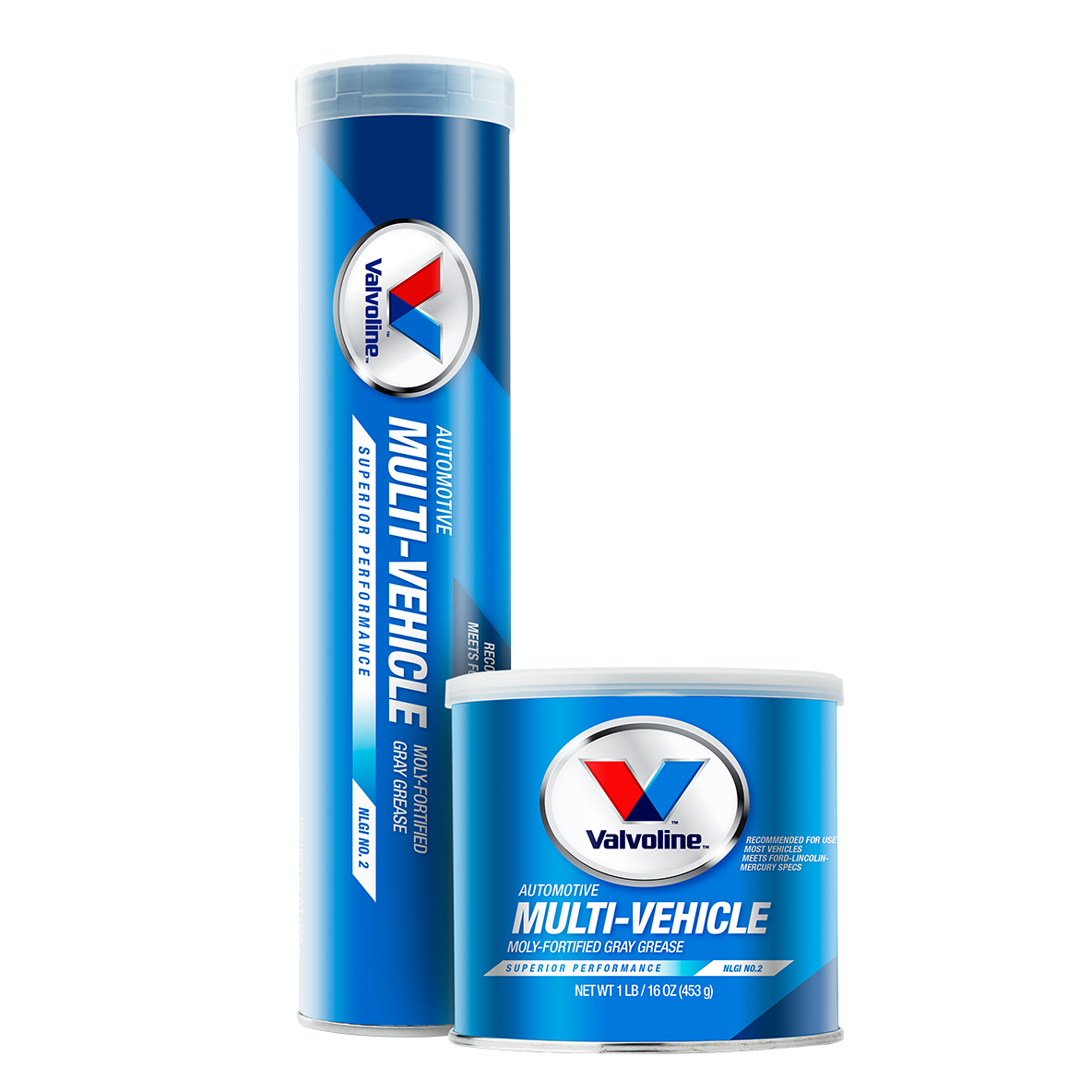

Any grease is better than no grease, but Moly based grease is not recommended for things that roll. It's too slippery, and can cause balls/rollers to slide instead of roll potentially flat spotting them.
Ford recommended Moly-based grease for wheel bearings. I keep a tub of Valvoline "Ford-Lincoln-Mercury" grease on hand.
  • Lubricates at temperatures ranging from 0°F to 375°F
  • NLGI GC-LB Grade #2 Lithium Complex EP Grease
  • Appropriate for use where Ford M1C75B NLGI GC-LB is recommended
  • Designed for use in Ford, Lincoln and Mercury vehicles that specify a NLGI GC-LB grease
But mostly I'm using Valvoline "Red" multi-vehicle (GM/Chrysler) grease.
  • Formulated to provide extreme pressure and high temperature protection
  • NLGI #2 Grade GC-LB Lithium Complex EP Grease
  • Suitable for use where GM Part #1051344, Chrysler MS-3701 are recommended
There's hundreds of grease formulations. For automotive use, you're looking for one that's rated "LB" AND "GC". LB is for ball joints and similar, GC is for wheel bearings. The most-common viscosity is NLGI #2. Lower numbers are thinner (down to 000) and higher numbers are stiffer/harder (up to 5)
Be really careful mixing greases. The classic problem is using a clay- (dirt-) based grease and then mixing with a soap-based grease. The soap predictably interacts with the dirt. There's lots of charts on The Internet showing potential interactions among the various kinds of grease. Here's an example:
Bulk loading of a grease-gun typically requires flipping the rubber seal around compared to cartridge-loading a grease-gun. But that wouldn't be an issue if you're merely re-filling a cartridge.

What I always found odd about the moly for roller bearings was not recommended was when ford started using disc brakes they had bearing and spindle trouble and ford disc brake grease was a moly grease GM disc brake grease was conventional smooth brownish standard looking grease never figured that out

Ford couldn't engineer a decent oil-pan drain plug in the '60s and '70s; they couldn't design a proper spark-plug in the '80s and '90s.
Now you know why I go through way more "red" grease than "gray".
