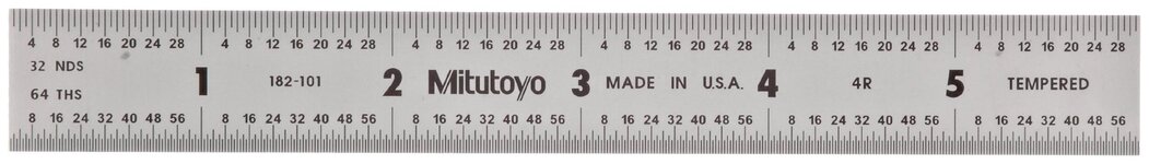

How thick is thick? I'm a huge fan of the Mitutoyo 182-105. It's 6" long, 3/4" wide, 0.050" thick, metric and inch, and surprisingly affordable for a precision machinist's scale.
