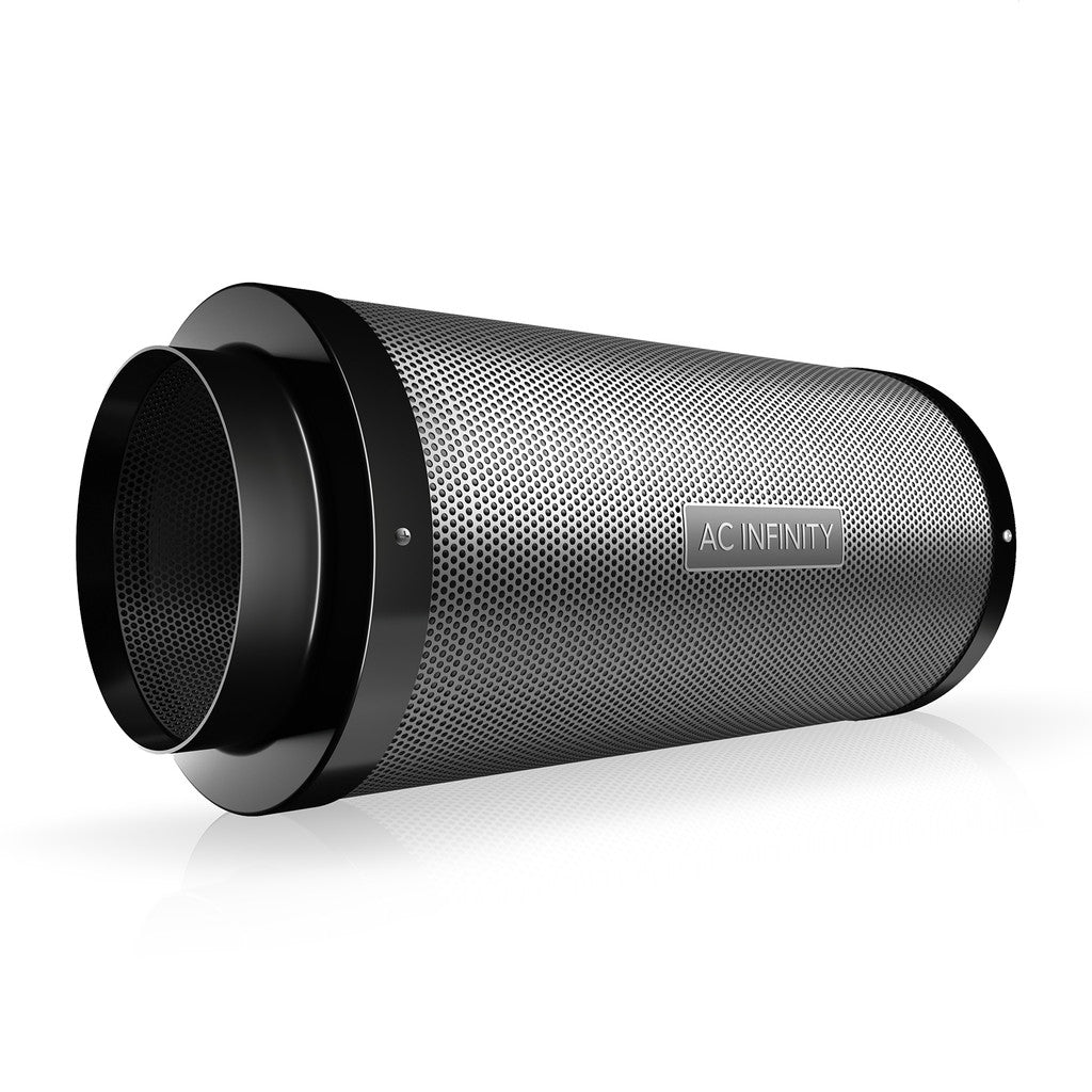

For general air circulation for dust and fumes, I was planning on running a series of furnace filters, inline charcoal filters etc to clean the air.
Unless charcoal filters have literally a >ton of activated charcoal it is totally useless. The thin charcoal filters in all retail filters are just fluff for sales purposes, good for about 3 minutes. Some of the HEPA filters can filter very low micron particles but no particle filter traps all particles

I was looking into the ones that are sold for the Marijuana grow industry. But certainly won’t be a ton of charcoal.
What is in a welding fume extractor?
