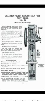

Good to meet everyone. Although the info here has been assisting me for a good while this is my first post. I picked up this post drill a while back and have recently gotten around to messing with it. I was hoping someone could help ID it. Only thing I can find on it is "Champion Forge Co, Lancaster PA" on the right side if facing it and "Warranted" on the left side. No model I can find, at least prior to disassembly. It resembles a a 96 but there are some distinct differences in, what I believe, is a quick return system. I have scoured pics and period ads for these and have yet to find one that exactly matches.

OK. Whew. I need to thank fciron over on the practical machinist site. He pointed me to a catalog list I hadn't been through. Looks like a 94 is the closest thing i can find yet. If anyone has any actual photos of one it would be greatly appreciated. Looks like the patent file date is 1877. This photo was found in a 1922 catalog.Screenshot_20221126_114558_Drive.jpg

I missed it on the vintage machinery site. If anyone has photos of one they can share so i can verify it's identity I can move to a disassembly and detailed inspection. I don't think a "pretty" restoration is in order but I think I may go functional and as accurate as possible for the nature of the drill. Keep the patina but make it usable and relativly accurate. Winter is almost here and the potential of motorizing it isn't out the question. Playing around with pulley sizes to keep rpms under the max etc. I have some old books that discuss line shaft design I may crack open. Just something to keep my brain working on days I can justify not working outside.

It's a nice bonus to have the back gears, most post drills didn't have them. When post drills are converted to electric motor power, it's a challenge to get the speeds down low enough.

Unfortunately I don't have facebook. I tried it once and got hacked within a week and never looked back. The return gears on mine are missing a bunch of teeth. Tge main forward gears are fine. I may see if a machinist buddy of mine could remake them. There's the option for re building the teeth too. If anyone has any input or suggestions I'd love to hear them

As an update, one machinist friend of mine forwarded me to a company called Motion Systems INC in Michigan who he spoke highly of. I spoke to a helpful fella and this may be a viable lead as they offer repair and re work services. I made contact and they were quite pleasant. Of course cost is yet to be established as I have not begun the disassembly process. I need to send the gears to them for evaluation, which is a logical request. I have another acquaintance who is a machinist at another local shop I need to check with before I send the parts off. I will keep you guys and gals updated.

You're going to get a crazy amount of money invested in that drill if you hire someone to do evaluation/repair/replacements on those gears.

Yeah I'm cautious of that. I'm hoping my other buddy can do something with it as he works for a more formal outfit with insane manufacturing capabilities. I just haven't had time to check in with him yet. Work and life are keeping me on the run. Throw in a dash of Christmas and you get some crazy. All in all if it is possible at a reasonable cost i will move forward. If not it's still a fun project. I ended up printing this out on hand made paper and hanging over it.

I was missing a change gear for my circa 1900 Barnes lathe, and couldn't find one anywhere without going custom.
I didn't want to hand file all 52 teeth, so got the closest 3d model from McMaster, modified the file in Solidworks, and got it 3d printed from black nylon. The gear is doing fine for my application and doesn't look too out of place on the machine.
Just something to consider as if you have to make a custom bevel gear it'll cost a fortune.
