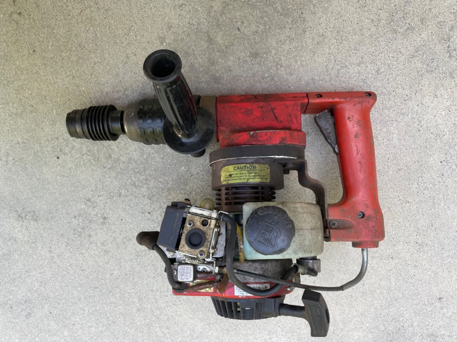

We used gasoline-powered Hilti rotohammers back in the late '70s for drilling and blasting when clearing trails--outside of the wilderness areas. Wilderness trail crews still hand-drilled. Somehow, blasting powder isn't forbidden in the wilderness, but gas-powered tools are.

This is the Hilti we used:
https://www.ebay.com/itm/3261070874...pMLtGE-W2baVlRgVYHC_6liqPPJhZvpxoCrBkQAvD_BwE

Good grief! Your arms must have felt like rubberbands after using that thing! o_O
