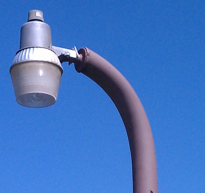

i just bought this house a few months ago and know nothing about this light.
i climbed my pole.
the bulb glass is clear, no markings, i forgot to check bulb base. (i don't know the precise bulb wattage)
**there are such things a self-ballasted MV lights.**
i'm planning to remove this bulb in favor of a lower wattage bulb with possibly motion sensing.
what is the quickest and easiest way to determine if this fixture has a ballast without tearing the fixture open?

The warm up time on a mercury vapor bulb is to long to be on a motion sensor. You should change out the fixture to halogen to be on a motion sensor.

Forgot to add... the wattage bulb in your MV fixture is the only wattage that it will take. The ballast is sized for the bulb wattage. It's probably a 175W bulb, so you can't go down to 125W. This is my limited understanding of MV lights.

I'll bet a fixture housing that large has a ballast in it. Are there any markings on the metal base of the bulb? Indeed, you don't want a motion sensing on a MV lamp, it will kill it real quick.

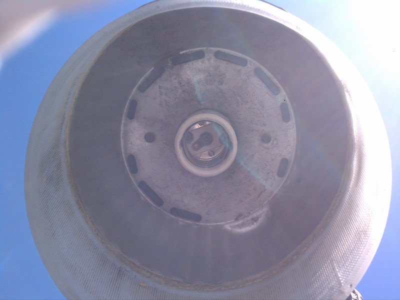

alright, no marking on the base, except for the letter R which appears at the top of the base (closest to the bulb base) and the R is printed twice,each at 180degrees.
(on the tip there are 0-9 and JFMAMJ-JASOND, which does not mark any date code)
Thanks for factoring-in the size as a good-measure factor.
Can the ballast be bypassed and still keep this fixture?

i'm going to modify the fixture and the bulb socket, stuff 1 or multiple standard CFL bulbs into the lens
**totals about the same price as a new MV bulb.
lumens will be greatly reduced, but 7800 lumens is too much for the area i'm trying to light.
