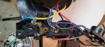

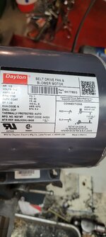

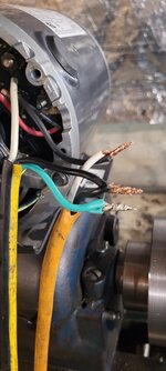

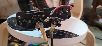

Help wiring a Dayton electric motor
wyliesdiesels
Aug 14, 2012
20,192
Modesto, CA
Terminal 2 is a teardrop shape with 2 in it and the red wire is attached to it. What is the number in the teardrop under the red? If it's 5, then there are parts missing......like the terminal that sticks through small slot at 5.
Is there a 5 close to the black wire? I don't think the black wire is in the right spot. Could easily be wrong though.
theres nothing missing. the black wire is on #5
