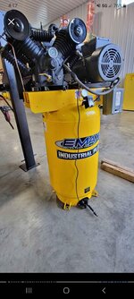

Hi guys! I'm looking for some advice on which fittings to use for my new air compressor. I have a home shop that I use to restore cars in my spare time, and I've been slowly equipping it with better equipment as I'm able to find deals on Facebook Marketplace, etc. I recently picked up this compressor, which is an enormous upgrade from my little Craftsman Professional, and am looking for some suggestions on which size and style air fittings to use. This thing is a beast, and was pulled out of a car dealership when it closed by the compressor dealer. Way more than I need, but I got a smoking deal on it, so it was cheaper than the 80-gallon Ingersoll Rand I was looking for. It's only about a year old. I have a 3/4" Rapid Air kit that I plan to use to distribute air. It has 3/4 outlets on the blocks for couplers, and this is where I get confused. There are several different styles in 1/4, 3/8 and even 1/2". Everything in my shop has 1/4 Industrial-type (M) fittings now. Should I reduce with a bushing and stay with 1/4? Upgrade them to 3/8? I don't mind the cost to change everything if there is a real advantage. I mostly run air tools and a sandblaster. Any advice would be greatly appreciated. Thanks!

In my non-professional experience, 3/8” quick-connects are a pain in the *** to couple and uncouple under pressure, but I do have a dedicated 1/2” hose with 3/8” couplers just for my 1” air impact. Everything else in my shop is 1/4” fittings and 3/8” hoses.
My air header is 1” galvanized, tho
Snapped-off
Feb 22, 2012
4,865
Indiana
You can get type M in 3/8npt so you don't need a bushing.
Or upgrade to type V. Available in both 1/4npt and 3/8npt.
GeoBruin
May 5, 2018
3,760
I personally wouldn't go with 3/8 fittings. High flow 1/4" fittings are capable of almost anything you can reasonably throw at them, and they retain the size and weight advantage, ease of compatibility with most tools, and cost advantages of 1/4" fittings. For things like blast cabinets, you shouldn't need a quick connect at all.
If you ever do need more air, you can crank the pressure up at the regulator and you won't see much pressure drop as a result of the fittings alone.

Thank you kindly. This was super helpful.
Based on the comments here, it looks like I should either go Milton V or High flow M. You guys are awesome. Thanks so much for the help.

Thanks for the correction on Stedlin. I'll have another look. I did get the compressor set today. Still need to tidy things up and finalize the air lines, but it purrs like a kitten. This thing is a BEAST. Small upgrade from my old Craftsman...

I'd still still with Milton v style 1/4" for basically everything, except for the sandblaster. Straight pipe the sandblaster with a full bore connector or swivel style npt connection in the 3/4 or 1/2 minimum.
If you have larger impact it may be nice to have a larger quick coupler too for occasional HD use ie: 1/2" quick coupler you can hook a 1/2" hose to for 3/4" impacts, if you don't then no worries on this one.
And x3 on the nice compressor!!
no704
Apr 27, 2016
5,289
Nice score. For normal hand tools 1/4 is plenty. Depends on use but might hard plumb the blast cabinet.

Hadn't even thought of hard plumbing the blast cabinet. That will happen for sure. The gun uses 3/8 line. Should I upgrade that to 1/2" or just reduce at the valve?

Milton V stubs and Prevost (preferred) or Dixon quick disconnects. The V stubs are way cheaper than any other brand and the Prevost and the Dixon are superior to the Milton V quick disconnects. 1/4" V will do everything you need.

Compressor is Sweet ness!
I think you need to add a drain leg ….
I the on line Info says drains
F
flyguy79
Sep 15, 2019
17
Thanks for the catch, man. I think I'm okay as routed, as there is a drain on the filter/regulator and also on the block to the right where I'll put a coupler. There is also an auto drain for the tank that automatically blows water out every 45 minutes.
