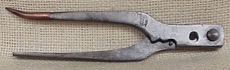

Howdy everyone, got a couple pairs pliers I'm trying to figure out. Both marked with "SOS" and an "A" inside a shield logo (I think). One pair has a carved out jaw on one side, the other has concentric circled out jaws. I have not been able to find a maker/brand or intended purpose. Any insight or thoughts would be great, thanks.

They look like blasting cap pliers; the side holes for bending the wire for insertion in to the plunger.
Does Atlas have a logo/trademark using a shield?
Could sure use some better pictures of the jaw inside & maybe a ruler/scale for reference.

Whoah! The blasting cap pliers I've used (many years ago) were non-sparking. Seemed like a good idea to me when priming a five lb bundle of 60-40 for a muck shoot.
Those were for fused caps. I'm not real sure why you need pliers for electric caps.

As far as the age of the O.P.'s pliers; old - drop/stamp forged handles; blacksmithed together.
Another clue, if they are Atlas; the Hercules Powder Company and the Atlas Powder Company were formed after the Dupont monopoly was dissolved in 1912, per an A.I. blurb from a Google search.
O.P. where are the additional pictures requested of the jaws; the "concentric circled out jaws" might just turn out to be fuse cutters.

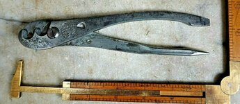

Thanks everyone, I didn't say anything as to not lean anyone's thoughts in any particular direction. My best guess was mid to late 1800's blasting cap pliers, I just can't find a dang thing on the "SOS" or the harp/shield/ upside down omega/ohm symbol with an A inside it. I've exhausted archive.org and alloy artifacts. Assuming these are western made due to English letters, I've searched European sites with no luck so far. Here's more photos.

Appreciate the additional pictures.
As above; if the A is Atlas Powder Company, tool would be after 1912
S O S; I'm sure you already suspect mining or rail road company customers - might be a decent direction for more research if so.

Yeah, was trying to get the better quality ruler photo to post, wouldn't go? And the SOS, I found (services of supply) for the army, but that was in 1942, different logo and no info, and (I think) well after these were made.

The other, (half jaw?) Pliers do have a flat head on one handle.

Thanks for the research & sharing it. My Grandma used to say "A days not worth living if you don't learn something new"
Am sure you noticed the 'dressed' end on one of the handles of the pair with the side-drilled holes. "blasting plier" is close enough for grenades - thing is; as you know, these guys are OLD, early in the evolution to modernish tools - coarse embossed nomenclature, rivet in the pivot - clues I'm observing - tools my Grandad & Great Uncles used; as a kid, remember watching them blowing stumps.

For starters, why is point no point even an issue; the O.P.’s images show two pliers, four tips; none pointed. The O.P. further mentioned up-thread that one tip was fashioned into a screwdriver tip; an Old World attribute that was included in early American made pliers.
four.cycle, I know that you have observed in the three images you include that given the pivot hardware and perceived manufacturing processes; the images are of tool made further down the time-line than the O.P.’s.
If the A in a shield is for Atlas Powder Company, founded in 1912; an ad in a 1918 Mining catalog shows a pair of Atlas Cap Crimper pliers with a pointed tip handle.
