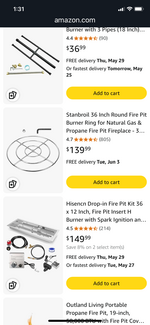

I am looking at building a 48" patio fire table for my wife. Any recommendations on hole sizing for the burner?

your burner size and hole sizing will depend on the type and shape of burner you're using (round, linear, star, etc.), the BTU rating, and fuel type (propane or natural gas). once you dial in what you want, then we can figure out the size of the orifice

My neighbor built a couple of setups using these. They work well. He built a cocktail height table and the flame danced around due to the breeze, but his other one sits lower and has no issues. He put a glass surround on the taller one and it has helped significantly.

Buy a burner, fab the rest.
