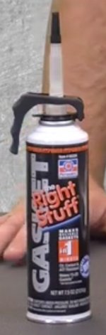

Any experience with the Right Stuff Gasket Maker with the PowerBead Applicator Nozzle?
See pic.
How long does it stay good in the can from the first time one opens it? Anyone freeze the can and get a longer open shelf life?
I am happy to spend more for a bigger can, but if it is going to dry out in a month what is the point.:willy_nil

Thank you. Any idea of how low a temp it can be applied in? Read the TDS but did not see that info.
It will be about 35 to 40 here when I need to do this.

tip leave a little squeeze out the tip and let it dry, when you go to use it again you can pull the dried out of the tip and fresh to use

Mine lives in an unheated garage that can get to 0F a lot....coldest it has been while working though is closer 40's.

Don't know about those type cans. Get the caulk tube kind and squeeze some out the tip when your done. If it sits for a couple months with out using, pull the cork and squeeze some more out the tip. Seen Right Stuff do some amazing things.

Keep it in a warm place until you need it. Apply it like normal but expect your dry time to take longer.
