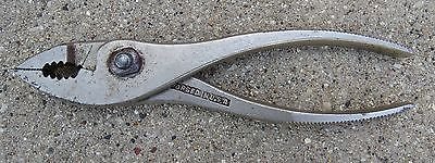

I've searched the internet, but can not find a source for the nut and washer for slip joint pliers. I'm working on an older SK 7510 at the moment, but will need the same parts for other brands also. Any help would be great. Thanks.

An SK 7510 is a tongue-and-groove plier, not a slip-joint. Slip joint pliers have a bolt and nut that literally slips back and forth to allow two different jaw positions. The most common vintage slip joints use a nut like the one of this pair of Diamond K36 pliers (see attached)

It's a nut. Find the thread size and buy a nut. If you're picky, get a stainless but and shape/polish it to your satisfaction, then add a wave washer and stake it once it's tightened enough, or red loctite.
