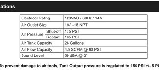

This is the comparable California compressor that I can find. It looks like a nice compressor. No doubt, one of the quietest you will find.
The Fortress I am looking at seems to edge it out on SCFM, Pressure, Capacity, and a brushless motor. The weights are the same. California is quieter. 60 vs 68 Db. and has a bit smaller foot print. I am going from something that is probably in the 80'sdb to 60 something. That is a dramatic drop. I am sure I will be happy with either. Pricing is in the same ball park. My guess, Which is dangerous, is that the Fortress would be easier to deal with any potential warranty issues. The only recurring negative I read about on the Fortress is the quick disconnects are hard to use when the pressure is up high. To get around this people run the pressure down on the regulator to add a hose. Will that be too annoying? I am not sure?. It it impacts the connection at the end of the hose, maybe. I do change air tools out a lot.
When I read reviews, I discount most of the 5 stars unless they provide incredible detail and they used the product for some time. I tend to look at the 3 and 4 as i get the sense they are typically more objective. Nothing is perfect and I want the review that will flag that imperfection. Evan if it is minor. 1 star reviews can also be relieving but you need to use a lot of discretion.
Am I missing anything?

8 db (if the ratings are trustworthy) is huge. That is almost cutting the noise level in half.
I understand the DB system. It is logarithmic. Sure. But compared to something in the 80's it is very dramatically. It is going to be ~4x times quieter. The example I saw on the California sales page was 60's is a conversion where 80s is city traffic. Are they trustworthy.? In the comments most people comment on how quiet the Fortress is. It is relative to anyone experience. Anyone with a DB sound meter can tell us their experience with a metric.

I didn't catch that the Fortress compressor claimed 68db. I will say that using my phone to measure noise levels my CAT which claims 60db is more like 70 at 1 meter. It's still quiet and not at all frustrating to work around. As I mentioned above, the GY compressor is just as quiet.
Looking at the 3 options (HF, GY, Hart) I would probably go with the GY since I've personally had experience with it. Absent knowing the difference in sound level and assuming the member price I would have picked the HF. I don't think any are really rugged units nor would any be obviously bad.

Let me start by saying I think you're going to be very happy with any of the options discussed. As you noted, the significant drop in noise level you're going to experience is going to be eye-opening. The challenge here is that there is not yet a standard, or at least not one that is widely understood and accepted, to which these manufacturers adhere when rating the noise level of their compressors. They all report sound levels in dBA, but we are rarely told at what distance from the source the measuring equipment is taking the measurement.
I used to be a huge flashlight nerd and we went through the same thing. Flashlights would advertise their max luminous intensity in candlepower, which we all thought was standard. The problem is candlepower is simply a measurement of the intensity of light at the measuring instrument. But the distance the source of the light is from the measurement can significantly impact the measured intensity. As a result, we started to see "lux" become the standard unit. Lux is simply candlepower at a standard distance which happens to be one meter. We need something similar for sound measurements. Something that indicates the test was performed at a standard distance like 1 meter.
Anyway, I have attempted to dig up some information on these tests in the past and I have been able to find where some manufacturers have specified the distance at which they measure the sound. Believe it or not, Harbor Freight is one where I have found a distance specified. The graphic below is taken from the user manual for their 26 gallon fortress compressor. You can see it says 69 dba at 3'. I have seen others that measure at 5 feet, and even 10 feet.
In short, it's difficult to truly compare the noise ratings without knowing how they are measured. In general my experience has been that all of these quiet oil is compressors are really freaking quiet compared to the oil is compressors of days past and even compared to fast spinning oil lubricated reciprocating compressors.
