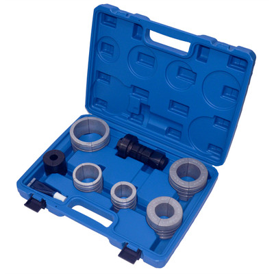

It's the same set as an Astro 78835 except for less grease and HF uses a stupid thread size that doesn't work with a hydraulic knock out set, so I'm not sure why anyone would buy the HF for 40% more.

OK I found it for $100 on Amazon. It looks almost the same. 28mm drive tool. The HF reviews say Maddox takes a 26mm drive tool. Other on line tool outfits it is more $ and with the shipping and tax is competitive with HF.

They aren't exactly the same, the AP set threads into hydraulic tools.

Here is an update. I received the AP tool. It looks very well made with a tapered roller bearing and heavy dies. The case look like a solid hard plastic case with decent hasps. It came with two tubes of grease and extra O-rings. It does say it's intended use is for mild steel. However it later says it will do Stainless Steel but it will reduce the life of the tool. It only says to grease the threads but I would assume you would want to grease the dies at any point they slide over each other including on the ID of the pipe. I did see a video where someone tried to expand a stainless steel pipe and his 300 Ft.-Lb rated impact was not powerful enough to finish the job. I assume if he started at the outside and took a smaller section at a time it may have worked. It could take a very long time. It sure looks like You do not want to expand stainless by hand.

Stainless is a PITA with any brands'. It's going to be tough, you'll need a high torque, never thought to grease the dies. We grease the bearing, thread and the female threaded expander. None of the expanding dies, guess it cant hurt though. You're going to have to just send it and find out if it's too thick.

I plan to lubricate both. I am not sure what kind of grease they provide for the threads. When that is gone I will use bearing grease or what is in my grease gun at the time. For the die surfacesi may use a silicone grease so the orings are better preserved. Silicone is good on rubber.

Any high moly grease for the threads works well.
