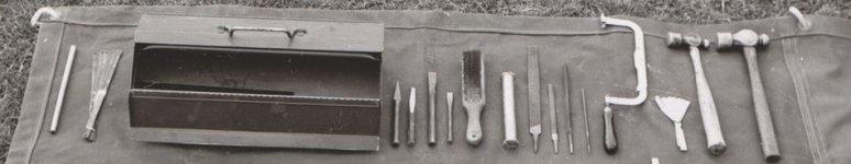

Over the past few years, I have put together a few WW2 toolsets and am constantly collecting WW2 era tools. As Lugz noted in his very thorough reply, the variety of toolsets produced was staggering. I’ll start with the onboard toolset that would have come with my and every other WW2 Jeep (with some variations depending on brand and year).
-DonC58E67B5-2B80-4624-A40A-ABDE39CDE3DA.jpegA7A21031-63C2-48DE-8435-43354A579360.jpeg729BBCE2-D144-403D-B38B-37D0E1491AFA.jpeg

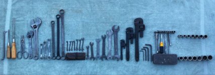

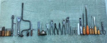

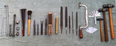

Here are some images of an early Motor Vehicle Mechanic’s Toolset. I’ve tried to accumulate tools that would have been in the set around 11/42.
-DonA0DBA3A5-1D53-4C08-BB8A-8D8687AF8E14.jpeg4758AF38-0159-4A14-89CC-7324F5F33519.jpeg0E4CBF97-0838-4763-9A80-8477B2357504.jpeg44D62D6E-5A6F-4C44-BF08-E9424E10E031.jpeg1BF731EE-0828-428A-828E-90F5C834AEBD.jpegEF3D32F0-2E8F-4601-9E5E-0423A10604A1.jpegA13CFB40-0FFF-496F-AC10-FFF73432F785.jpg

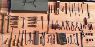

My GMTK is the set I’ve been working on since 2014. It is a bit of a hybrid, containing most of the tools used in these sets from 1938 to 1945. I am constantly on a search to upgrade the set and these pictures have been taken over several years.
-DonA571FD2D-CD59-43E2-B186-9DF23F8E2DAF.jpegAF8DCCB7-F99F-4B13-8E21-72A981AE7D66.jpegA7AD7236-B857-4F8E-935B-9DEB3EC0753C.jpg427BA81C-7140-4E1D-A648-FC6F41E2FDE5.jpgF116AF5E-3958-4803-99FF-2A0350AB0FE3.jpg0E46FE27-459E-4188-902E-D267622D14A3.jpeg69082B1C-AF32-4EF4-A3CD-3C354BC6C9C4.jpg

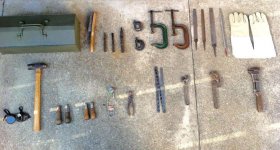

My current project is a Carpenter’s Set No. 1. I found the box during the summer and have been gradually adding to it. I still have a ways to go but it’s coming along.
-Don77A42C14-C6AB-46FB-A08C-34A996DEF936.jpgD120959A-BD73-4DAE-9F2D-5F6C4427CB27.jpgFB2EF7F2-8661-43CE-A7F2-5FA65A6646AD.jpgE03C01E7-52D0-4238-ACA0-7ABDE457F386.jpg5491B7CB-1E97-4844-9862-EDFF432FA1EB.jpg9C8194A4-1065-4C2B-8F7C-B73E50EB3FE1.jpgFFC99E27-B13B-4EFF-AC7E-46028771022D.jpg

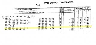

Here ya go, Roob. They were making the chests for carpenters' kits, late war.

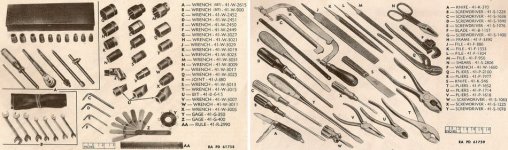

As long as you ask - which I really appreciate, I am going to use this thread as a platform to make a plea! :)
We do have some compelling research needs...
I am always looking for a wartime version of Section IV of the Federal Standard Stock Catalog, which are Federal Specifications. I have the 1939 Fed Specs, which is close, and they have been a big help, but they are a little dated (requiring some interpretation and analysis because of that), and they didn't include many tools that the Treasury Department simply wasn't buying until the war, that were added to the catalog, especially in 1941, 1942, and 1943.
They would look exactly like this if found still bound...
..or like this if loose...
..., but have different dates.
I am also always looking for ORD 5 SNL's. The ORD 5 was the ORD's master catalog. All tools, by category, irrespective of which tool-sets they could be found in. I am very fortunate to have original issues of the J-2 (Cutting, boring, and tweezing tools) and J-4 (Punch, drift, fastening, and scraping tools), which covers pliers, wrenches, screwdrivers, etc, which is about 75% of the tools in the GMTK (and roughly 75% of all automotive hand tools). I also own a J-1 (Abrasion and compression tools), which includes hand grinders, sharpening stones and the like. But it would be great to have the following..
J-5 Lifting, holding, forming tools. (bit braces, saw frames, vises, clamps, hoists, block and tackle, molds for castings, anvils, jacks, and slings.)
J-6 Percussion, digging, and wrecking tools. (hammers, mallets, mauls, sledges, axes, hatchets, picks, mattocks, shovels, crowbars, pinch bars, etc.)
J-7 Welding, forging, soldering, and brazing equipment. (blow-torches, soldering coppers, melting ladles, and welding outfits).
J-8 Hand tool appurtenances. (file cleaners, handles, heads, tool checks, tool racks, etc.)
J-9 Measuring and testing instruments.
J-10 Small tools. (twist drills, countersinks, counterbores, cutting-off tool cutters, cutters etc.)
J-12 Tools, Maintenance, for repair of group B materiel
J-13 Special tool sets for field artillery, and combat vehicle weapons
J-14 Paint, spraying equipment, and related items.
J-15 Benches, tool boxes, cabinets, bins, tool chests, tool rolls, etc. of general
application.
J-16 Tire repair, and maintenance tools, and equipment.
J-17 Common hand tools
J-20 Miscellaneous kits and tool sets
The covers would look exactly like this...
...but SNL J-x and a different title instead.

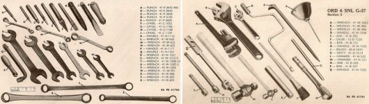

I am also always looking for the following to fill in a very short and minor time gap we have:
- March 1944 ORD 6 SNL G-27
It would look exactly like this…
…but with a different date.
If anyone runs into any of those at an estate sale, flea market, or online, PLEASE let me know and if they're affordable, just buy them. I will repay you! Thanks.
