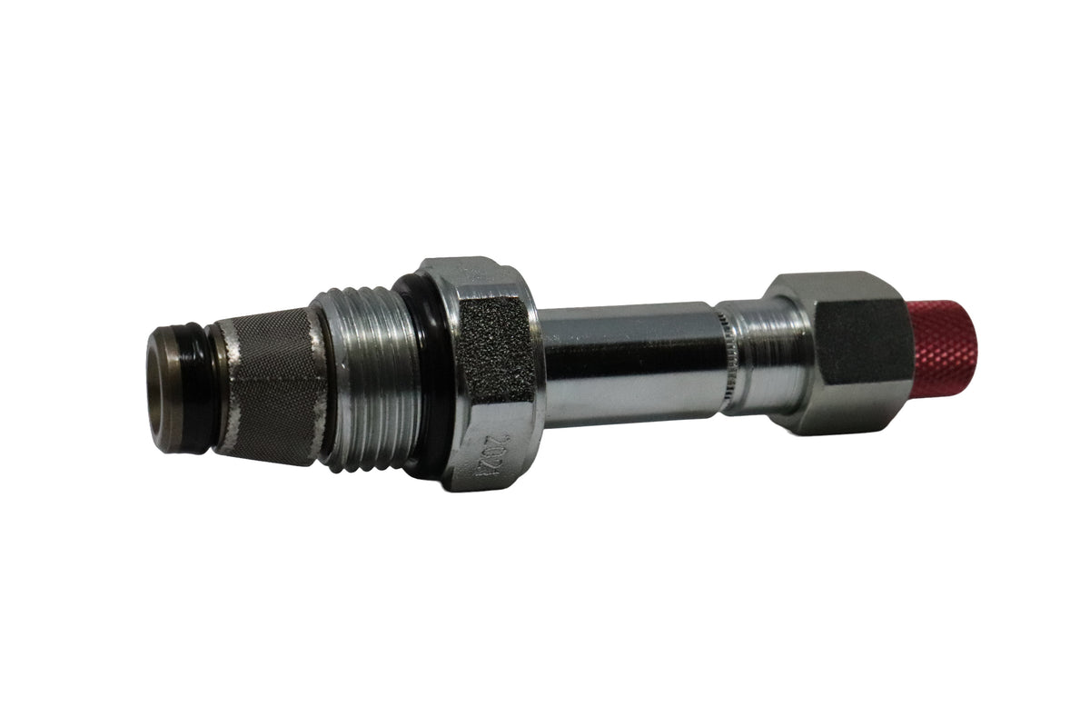

The solenoid valve on the right came apart, and I have no idea how. Pretty sure this is the problem. If you look at the pictures of the valves they both should look the same. For some reason the one on the right came out without the bottom half. I lost a couple of the small parts that are in the valve when I took it to my ultrasonic cleaner somehow so I am buying another valve. Valve is SV80-MS and both are exactly the same. You can see part of the valve in the body, it came right out with a dental pick

This is the valve for both

OK, that valve is just a bit longer than the original, but it works fine, other than you can't put the sheet metal back on unless you cut a hole in it or pad it out somehow. Leaving all this info here for the next guy with this problem. Had I realized initially that the valve on the right had come apart, I could have saved lots of time and effort.
