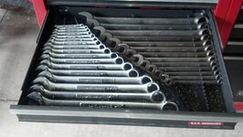

Back in 1980 or 81 I bought a full set of Proto black oxide combination wrenches. I liked the shape of the shanks better than the thinner Snap On combo wrenches. I got the black ones instead of chrome for a couple of reasons. One reason was that I knew I would likely be using a hammer on them now and then, and would feel better about doing that to an industrial finished tool rather than a chrome one. Another reason was that they were substantially less expensive than chrome ones, but still the same quality.
I still have that set today although it is not completely Proto any more. Some sizes have had to be replaced with other brands and finishes due to getting lost though the years. I too have always liked the feel of black oxide finished wrenches - they just feel nicer than chrome to me.
