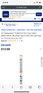

I thought my old fluorescent desk light had finally died. Of course, I had to look up fixing it here and on YouTube. With an extra, old T8 fluorescent tube I had in my garage and after taking apart the reflector to see what I was working with, I reassembled everything and it fired back up.
It turns out I have an old Dazor 2324 Floating Fixture Industrial lamp and it might be worth replacing the fluorescent tubes with new LED tubes. Instead of removing the ballast and rewiring it direct for LED tubes, I found GE Color Select LED tubes that would work without the need to rewire. Plug and play!
Here it is, wiped down with bike polish (it’s what I had), pivots lubed, and tubes replaced with bright modern LED T8s.
It is now very bright and instant on with the original power on and power off buttons.
The ballast is still subject to failure.. but I’ll deal with that when it dies. I just wasn’t sure what parts were the ballast (you’re supposed to snip the wires to it and bypass) and which were for the switch (still needed to turn on and off).

Those tubes appear to require the ballast to function. This was in the QA section: This LED tube must be used with a compatible ballast.
I will consider them when I need to replace bulbs in my Dazors. Mrs No_Garage has one on her desk that could use some brightening up.
If it needs brightening.. go for the upgrade sooner than later. Fluorescent tubes can last a long time before they die. The select temperature option of the GE product at Lowe’s is cool, or warm, or.. in between 😅.
