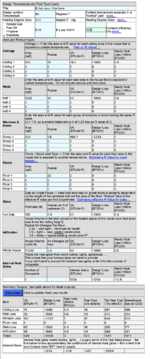

Agree, run your variables in the calculator below...
Your choice of mini split should be made with the min/max of a minisplits output, not so tied to the advertised BTUs as in.....
  • Min-Max Cooling: 3,100-12,000 BTU
  • Heating Capacity 12,000 BTU
  • Min-Max Heating: 3,100 - 22,000 BTU
Can you make sense of this?

FLguy....Design temperature is for heat not 90 degrees, more like 25 degrees in FL (January)
For a heat pump your efficency varies by SEER and HSPF eg my heat pump is a Fugitsu SEER 29, HFPS 13.8 it has an average COP of >4, meaning it is >400% efficient . Now efficiency costs, generally the more you pay the more efficient. Depending what you buy you could have a unit with an average COP of roughly 2 ( 200%) to >4 (400%). With minisplits you pay upfront with higher efficient units or you pay down the road with lower efficiency units.
The big factor with minisplits is how much you pay and expect to pay for electric costs in the future (KW rates, including taxes/surcharges). It really pays to get reasonably efficient units, maybe not super efficient like mine. With Florida, SEER (Cooling) is more important than HSPF, in most of the country/Canada, HSPF (heating) is most important.
Now the link allows you to compare minisplits with different efficiencies, I have tried other minisplit calculators, this spreadsheet calculator is in the accuracy range of others I have tried .....
