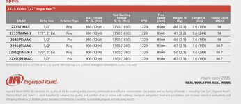

50-75 lbft, if it's only used for high torque needs, then most of the time you're using smaller quieter tools like the 2135QTI he already has.
30-50 ft.lb. according to the specs, but who’s counting at that point.
Yeah, so basically within the margin of error, I bet.
But 10db is huge. That's half the volume. I do like that they added a decimal for the Q just so they could make it look better
But 10db is huge. That's half the volume. I go like that they added a decimal for the Q just so they could make it look better
10db is huge.
I always wear ear plugs working with air tools but even still a strongly prefer quieter tools. This was a big part of my moving towards aircats for several items.
