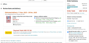

I bought the 8 piece Knipex set w/forged tips from Amazon.de a few years ago and added a few singles at the top and bottom of the range to round it out. Looks like $127.58 would make them yours, I'll attach a screenshot.
These are a joy to use - while women still snicker behind my back, and fish give me the finger, snap rings tremble at my approach.
Just checked, they are going to cost me $200 CAD and take like 1-3 months to ship or something. Mister Worker has this set on sale right now for $220 CAD. It's the precision ones. I might buy them but I'm worried about the customs fees. Has anyone from Canada ordered off this site before? If so how much did you pay in duties and taxes for your order?
