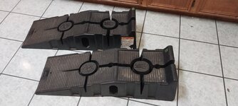

Noticed a crack in the corner of one of my Rhino ramps - the only set of good jack stands I have are currently occupied by a car, but I needed a couple for a different car so I put the first car on the rhino ramps so I could borrow the jack stands. While I was crawling around under the second car I happened to look over and see the crack in the Rhinos. They're probably 8-10 years old so I got a lot of good use out of them, and I already have a newer set and now will go buy another set to replace this one (which of course is going directly into the garbage). So I'm pro-Rhino ramps, but this confirms my belief that sticking a pair a steel jack stands under the car when it's on these ramps is a sensible idea. Also a PSA: if you have these ramps check your corners from time to time.

I did think about how I could keep them away from 'pickers'; if I can stuff them in my garbage can so it can be closed and no one can see them from the road I'll do that, because the garbage truck has a grabber that picks up the cans and dumps them into the truck and then they'll be gone -- not even the garbage men will be able to get them. But if they don't fit in the can then yes I'll cut them up or something, because where I live someone would definitely claim them. Probably it would be one of my neighbors and I like them!
The plastic still seems sound except for that one corner, and these have been stored indoors their whole life; the most extreme climate was a no-HVAC shop in the New Orleans area. So they got sweaty along with me when I was out there but they've never been frozen or out in the sun for an extended period of time or anything like that. I think the operator error I mentioned above was either driving up onto them too ineptly, letting a car onto them too hard (I've had at least one car that was too low to drive onto them so I had to jack up the car and then lower it onto the ramps), or getting the car on them too far off center, if you know what I mean. Any time I didn't get the car dead-centered on the flat part of the ramp I always fixed that immediately, but perhaps too much of that and the damage was done.
I didn't upload this picture initially, but you can see the bad one (left corner of the ramp on the right) is bulged in the bad corner. I think that started first and then the crack followed, so from now on I'll be watching for that kind of distortion and then retire the ramps if/when that happens, not wait for a crack to form. I do think Rhino ramps are safe tho - especially with jack stand insurance - and they're too convenient to quit using!
