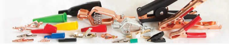

The BEST clamps/clips are made by Mueller. People in the industry know them because they have been around for ever ! They make several different sizes of clamps.
Not Mueller, but very good quality. I use them to make a cable to connect my 2000W inverter to my car battery (short term).

Funny timing I replaced the clips for the second time on my charger yesterday. When I replaced them the first time I bought some cheapos from Amazon and they were so thin you could bend the ears that were to crimp the wire by hand. That lasted about a month. I got some Muellers (the one right in the middle of the pic Oldwizzard posted) they are in a different class!
