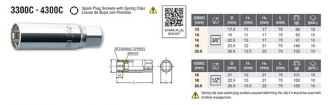

edit: for anyone that finds this in a search. Per the koken catalog they are the same size:
3300C-16 is 20.5mm diameter and 70mm long.
3300CZ-16 is 20.5 diameter and 70mm long.
Thanks to tamaraw for the catalog link.

Thanks for link to catalog!
I was able to find the 3300c-16 on page 286. 3300cz-16 on page 33.
Since they are same size will just go with the cheaper.

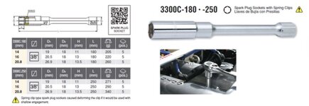

I also highly recommend the extension version of the spark plug socket. It’s all I use now, honestly.
Koken 3:8 Extension 16mm Spark Plug Socket 250mm 3300C.250-16.png
