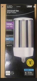

I have 2 of the corn cob lights and so far I’m loving the amount of light. 20,000 lm each c7552d066c7a05a8af09308db128bc90.jpg
LOL
I thought the problem with corn cobs was the fact that they throw the light horizontally, not vertically down, where it's needed. Maybe from Platonic perhaps?
